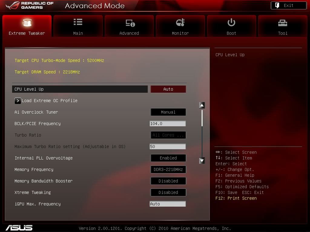

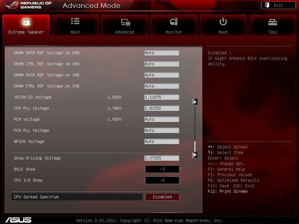

So I did my first SB Ln2 session last night an it was a complete fail. I know SB dont scale on Ln2 that much, but I wasnt able to beat anything I did on air. Raising vcore, vccio or cpu pll
didnt help. It seemed like the cold handicapped me. The mount was good upon taredown, that was my only suspension of what could have been the issue.
So can you have a crap chip that max's out on air?
in my experience yes, on my 2600k i cant get 5.6 unless its on the ss but on water i can get 5.5
so its not much more oc i can get on cold
on the ss i can run 4c8t on water i cant so thats the big advantage

These are my max air settings
104 bclock
54x
vcore 1.57
vccsaio 1.11875 vccsa an vccio are tied together on the z as far ad I read. ???
Dram 1.65
cpu pll 1.8125

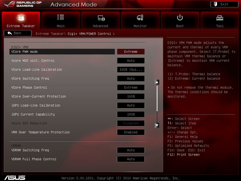

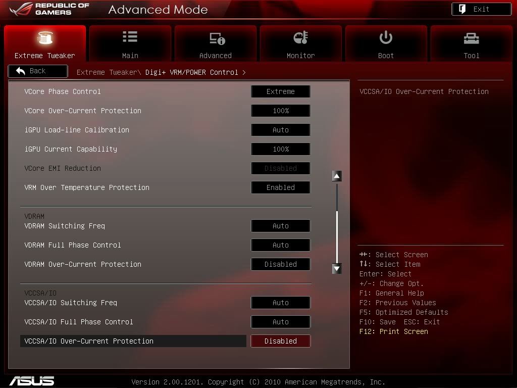

Here is a bios shot of the Digi VRM/Power tab are these rite?
The rest of my settings
Tried auto on skew driving voltages to

Gutterz, try this:
D/C overtemp protection
Lower your vpll to 1.5-1.65v
Increase dram to 1.7-1.75v+
Increase PCHv to the first yellow or the hightest white level

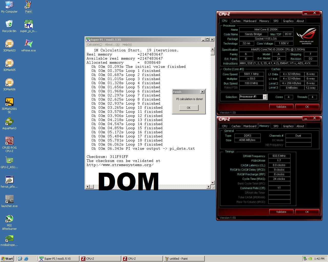

Old 12-18-2011
Nice B-Day for ME
i set 57 and 59 came out
