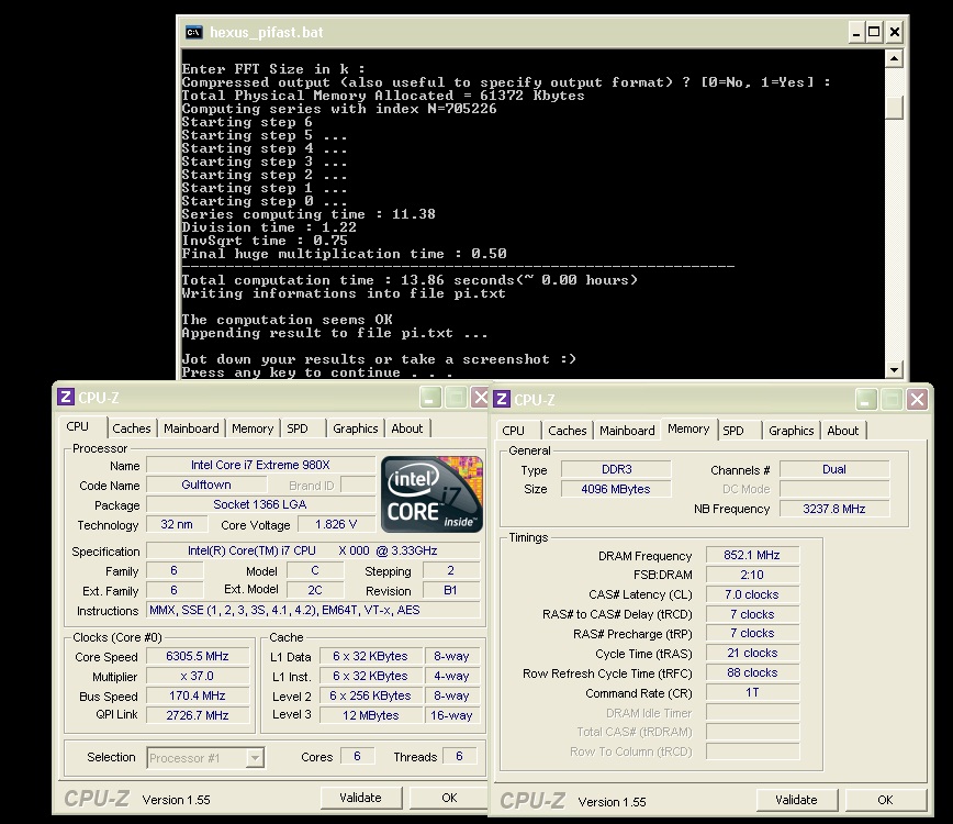

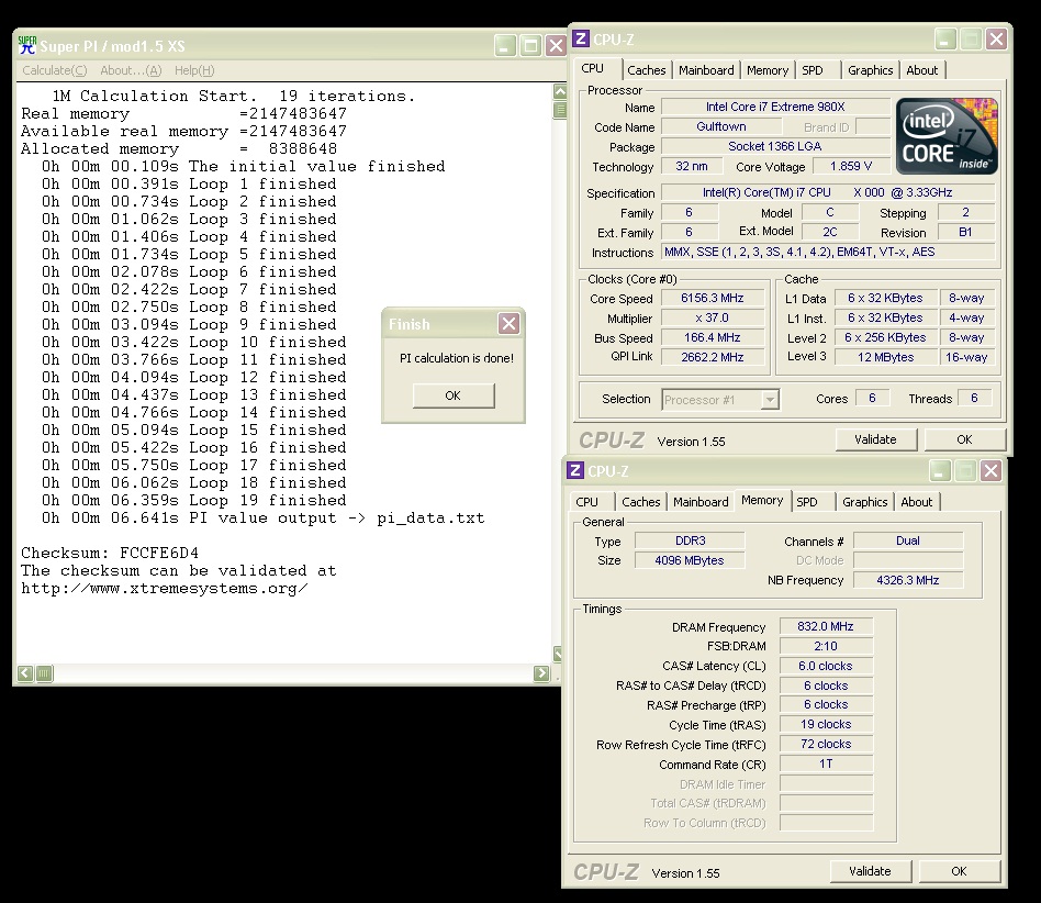

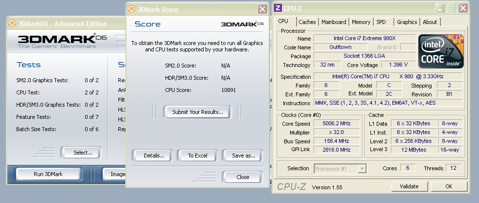

still trying to decide on which chip to keep. played with the 3018b tonight for a while. Wanted to get my 06 cpu test banged out and save a profile. Thought I would start low volts
Then focused on pi 1m
And ran un optimized pf with superpi settings Proper run with uncore and mem speed to come
Its a pretty nice chip -156cb -125cbb, vtt wont boot over 1.3 set but you can up to 1.4 in windows easy enough
PS slow mode, highe pci-e mhz and +25mV ref voltage ftw for 1m and pf gained about 200mhz
(shout out to dread for the pci-e and ref voltage tips)
Name:	5ghz 1.396v.jpg
ID:	3746   Click image for larger version
Name:	6.3 pf messin.jpg
ID:	3747   Click image for larger version
Name:	6.641 spi 980x.jpg

what are those rams? vdimm? bios?
  #298
Old 10-24-2010
ram is project-X 7-7-7 2000 super talent
bios is 704 (still the best 1005 is on my other bios and same settings dont fly)
vdimm 1.775v vtt 1.354 pll 1.503v
