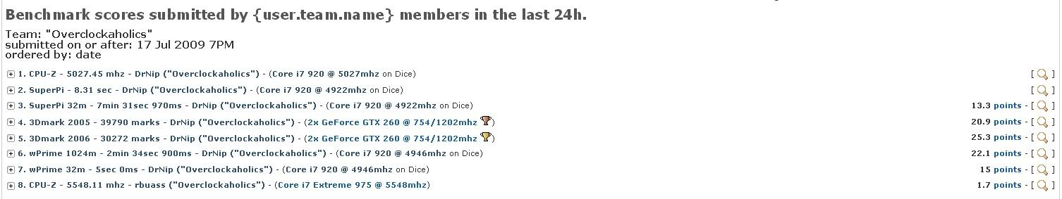

Well the #'s are in. Back at 322 points!

Cold boot problem fix with that jumper suggestion chuchnit!!!
Able to obtain a lil higher clock messin with those vtt/cpu pwm frequency volts Jody!!!
