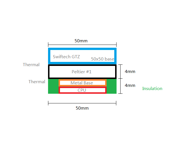

I am thinking about putting those 2 TEC peltiers back to back hooking it up in series.
Having the second peltier cooling the first one and having the water block cooling the second peltier.

Old 02-21-2012
Here is a pix of what the idea is gonna be

don't put sandwich plate TEC,
use them single, dual stage tec is not good on direct die cooling, only for small things like led's and lasers.
Use single TEC more power, 136w is not enough for cpu.
you need something that can cool down the cpu, and a cpu gives overclocked like say 250w,
so you need to cool down that.
Use a minimum of 226w TEC or 260w 50x 50 or 40x40mm.
And cool that down with good watercooling.

ok it's been 2+ week the damn stuff finally got here, and had my buddy come over with his power supply and here are some pix
I'd turn the 430W on first that only powers the TEC and 2x 120mm fans I'd normally hook up my temp gauge but for now there is too much stuff on the table
Here is the setup
With only TEC and the Fans on

pics of the block?
Temps under load ?
Old 03-12-2012
block? this is water cooled for now, i am working on the thing metal between the cpu and the tec.
i monna use Al for testing right now cuz Cu is a little out of my budget atm.
i am aiming for around 2~3mm for that part.
today is just a quick test nothing special about it...
since the cooler don't have the right mount i had to use my hand to hold the cooler so it not gonna move around.
here is a picture of what most likely gonna be the ending product
(water block is taller than that)
